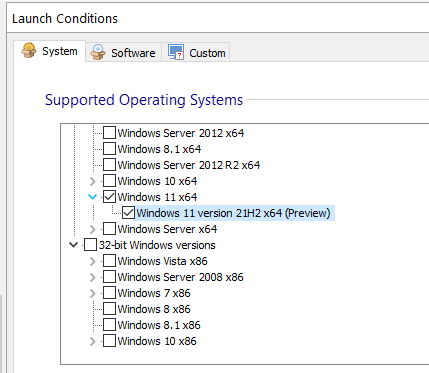

I have currently a setup for Windows 11 ARM64, which works well. Nevertheless if try to install this on the latest Windows 11 Preview, build 22622, the setup fails with the message, that it cannot be installed for that OS.
Within the launch condition page of AI I only can select "Windows 11 version 21H2 (Preview)" (build 22000).
And using a custom condition within the same page like "(VersionNT64 = 1100 AND MsiNTProductType = 1 AND WindowsBuild >= 22000)" did not help either.
So, my question is, what should I do in order to get my setup installed in any build of Windows 11 ARM64 system?

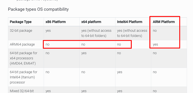

I'm not quite sure I understand. Are you trying to install the ARM64 package on a Mac or a computer with Windows 11 (x64 platform)?
Please note that this will not work and this is the correct behavior.
ARM64 package can be installed only on a ARM64 Architecture.
arm64 package.png (73.89 KiB) Viewed 8052 times
You can also check that on the below MSFT article:
App package architectures
