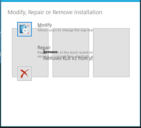

This
looks like this when in use
I am on my last attempt at creating an installer from start. If i cannot get the registry values to stop erasing or clearing along with updates not working as shown in your videos, im going to have to revert back to my other installer program because i know that works. It takes longer to set up but it does everything im trying to do...
Thanks for the help on the other threads, i would highlight though that the more questions you get in a short period of time only exposes either the lack or complexity of the help files you provide. Maybe you could include some scenarios and call out the procedures in a single page rather than send us on a bear hunt to gather for ourselves...

This may happen if the Enhanced User Interface (which is handled by our EXE Bootstrapper) is not enabled to run on "Maintenance" too.
In order to enable the "Enhanced User Interface", you can go to the "Themes" page -> "Settings" tab and select the "Always (install, uninstall and maintenance)" option.
Enhanced UI will be used when installing the application as well as when performing "Modify" or "Uninstall" from Control Panel.
This is happening because Windows Installer is not able to manage our "Enhanced User Interface":
http://www.advancedinstaller.com/user-g ... ed-ui.html

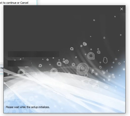

Hi
I didnt want that particular dialog, it just kept appearing. I digress, i changed to another theme that was all white (Air Flat). I went through all of the dialogs and they were all white until i tested it. Then it became white, grey and a space like full image that isnt part of any other theme...
I was expecting this
When tested, i got this
And this.....
What setting is required to make the dialogs look like the theme preview and not have this gaudy image that i cant remove?

This is quite strange. Have you changed the images in the Customizable Images section ("More options" button)?

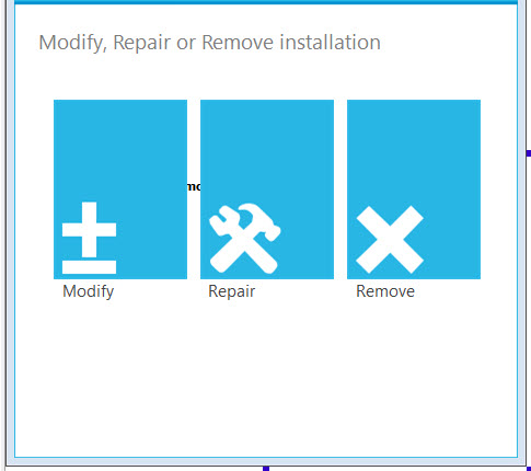

I'm not able to reproduce this on a sample project. Everything works just fine:
air white.png (139.21 KiB) Viewed 8064 times
Please forward to me the .AIP (setup project) file by email to support at advancedinstaller dot com so I can review its settings and further investigate this.

As per my previous reply, I'm not able to reproduce this. Everything looks good on my machine.
air white.png (139.21 KiB) Viewed 8041 times
It looks like somehow the default images for this theme were changed on your project. Are you able to reproduce this on a new project?
Please forward to me your .AIP project otherwise I cannot further investigate this.
