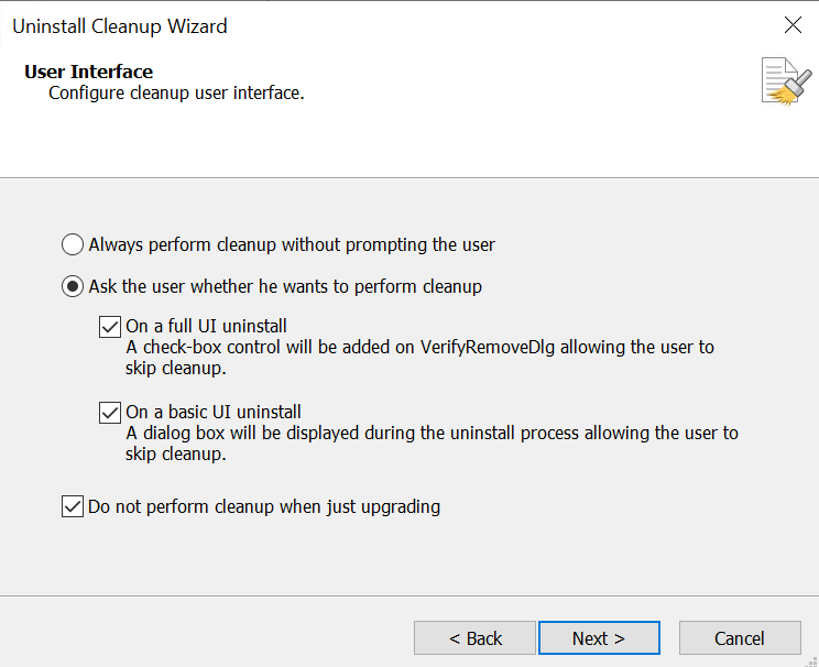

In your case, I think we can achieve what you need through our support for "Uninstall Cleanup".
The only condition for this, however, would be for the files to be downloaded in the same folder.
Say we have the C:\test folder where all our files are downloaded.
The first step is to recreate the folder structure in Advanced Installer. That would be creating the "test" folder under "Windows Volume".
After that, we can right click on the "test" folder --> "Uninstall Cleanup" and the wizard will guide us through.
After that, during uninstall, we will get different behaviors, e.g.:
- basic UI:
- full UI:

No, the article should not appear during the upgrade operation.
As it can be seen in the screenshot from my previous thread, there's an option there "Do not perform cleanup when just upgrading" which basically does just that.

I have another question regarding this feature but if we could do the same thing with our professional license minus the dialogs?
Would it be possible to have designated files and folders removed during un-install, except for when upgrading, with the professional license?
Basically everything the un-installer dialog was doing except for asking the user we would just automatically remove the files and folders. But again not perform this removal if the user is performing an upgrade? By upgrade I am speaking about an automatic process that detects a new version, downloads the new installer and then un-installs and installs the new version.
Re: Can we ignore un-install dialogs when performing an un-install via an update?
Hello Sean,
The option to not remove the folders during an upgrade should be available with the Professional suite, too.

Great! I was successful in implementing the uninstall removal feature with the option to ignore upgrades.
Thanks a bunch!
