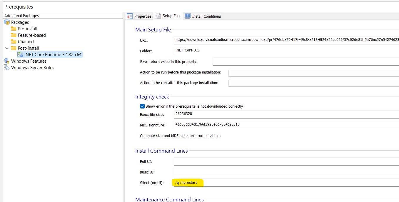

Hello Justin,
I'm not quite sure I fully understand this.
Do you want to silently install the prerequisite when the main package is also silently installed?
If so, please note that this is already the predefined support.
If your main package is installed silently, then the Silent (no UI) command line field is used for the prerequisite.
Each command is used by your prerequisite based on the UI level of the main package, i.e., if the main package runs with full UI the command from the "Full UI" field will be used to call the prerequisite, the same for the rest. This way you can have different command lines for each UI level.
silent prereq.png (50.89 KiB) Viewed 7390 times
Please let me know if that helped.

As a side note, it does not matter what prerequisite you have, I just tested the ".NET Core Runtime" on my end. You need to pass the appropriate command line arguments for your prerequisite (on the Silent field).
