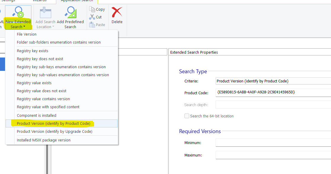

For example, in your main package you can create a search for each chained package to find out if they are already installed. On the Searches page you can add a New Extended Search by Product Code.

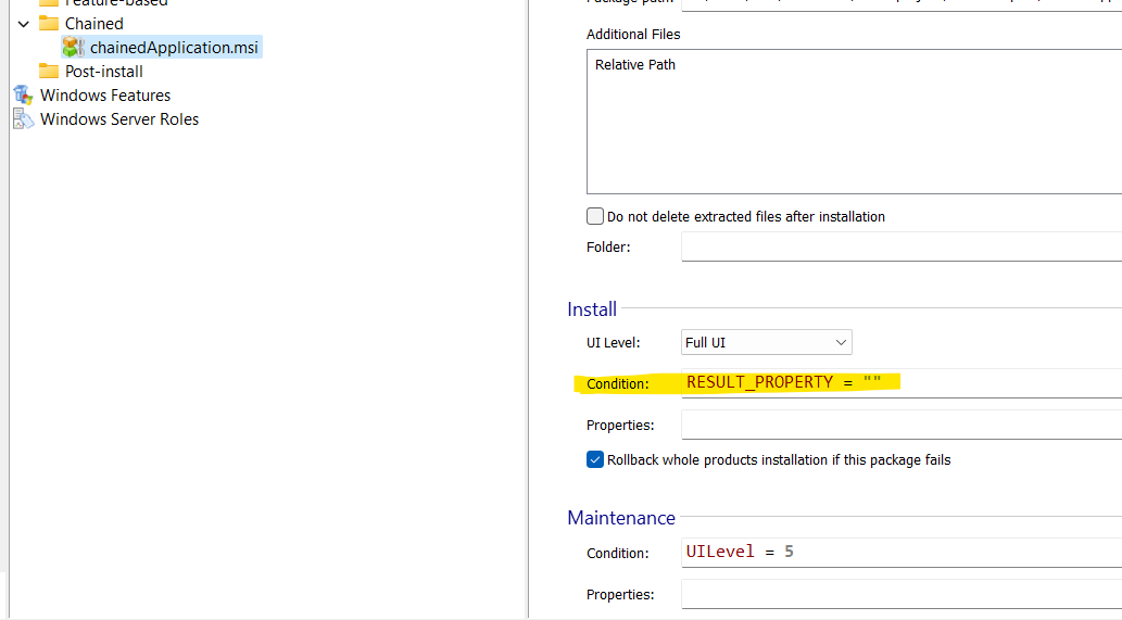

Then, on the Condition field of your chained package you can use the RESULT_PROPERTY = "" condition:
chained condition.png (27.76 KiB) Viewed 8009 times
After this, you should get the desired behavior.

It seems that the steps I provided in my previous reply were not followed. If you were to apply those steps, you would see that my solution is specifically tailored for this scenario (the chain package will be reinstalled during the repair of the main setup).
The install condition of the chained package will be reassessed during the repair. The predefined "Installed" condition refers to the main package which will be always true during a repair (the main package is installed), thus the chained won't be installed.
Please follow the steps from my previous reply. You can use the "1" condition to test this without implementing the searches.
