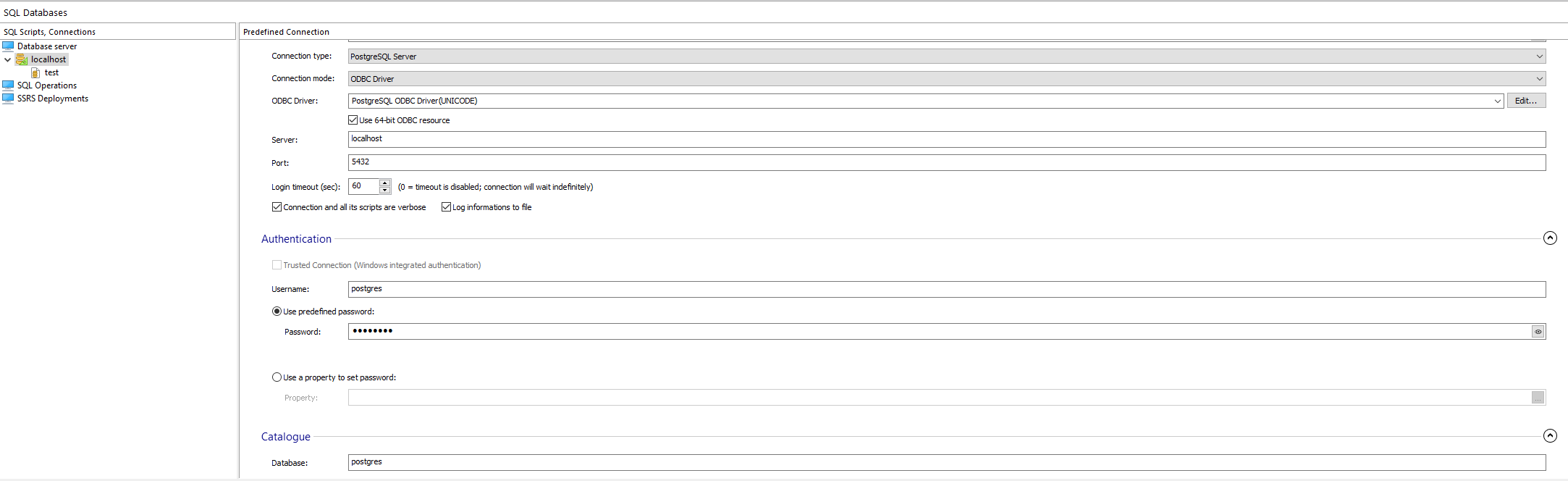

Hi guys,

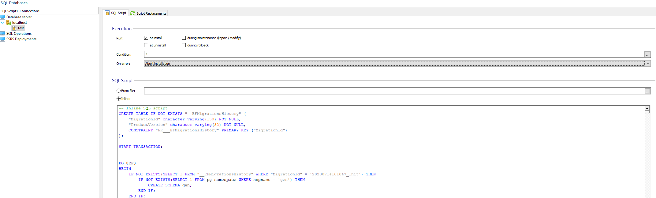

In Prerequisites section, I setup to install PosgreSQL from a file in disk, it installs successfully. However, in the SQL Databases section, I cannot configure to execute the inline script to create some tables or database in Postgres server.
Note that I used the Predefined Connection. Not sure what is wrong in my configuration.
My expectation is after Postgres installed, the script should be executed to create database and tables in there. But the fact is after installed Posgres, I use pgAdmin to check and there is only a default database without any tables that I want to create.
Please check the attachment for the configuration screenshots.

First of all, could you please let me know how you have added the prerequisite? Is it as feature-based, or perhaps post-install?
For example, if it was added as post-install, then perhaps the script tries to execute before the actual installation - this, however, should raise an error during the installation.
Other reason for this would be the incorrect connection. For instance, please make sure that the username and password are actually correct and that there is a database named postgres there. Also, the port number and the ODBC being 64-bit.

In Prerequisite section, I choose "New Package Prerequisite" and configured the path to the PostgreSQL installation file. I can confirm that the PostgreSQL is installed successfully with the "posgres" username and password I defined.
In the SQL Database section, I tried many types (Predefine Connection and Custom Connection), many connection strings but they seem not to execute the script.
