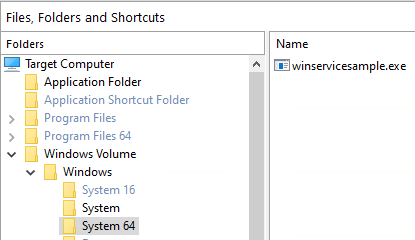

- in "Files and Folders" page, we will add the files accordingly - meaning the 32-bit dlls in the Windows Volume --> System folder and the 64-bit ones in the Windows Volume --> System 64 folder.
Path to the folders in the Files and Folders page
Below the screenshots for the files:
(please ignore the files that I've added as that is not importnat)
Now, for the file in the System 64 folder, please right click on it and then "Go to Component". For that component, please make sure that the "64-bit component" option is checked. Additionally, the opposite should be true for the component of the other file (i.e. the component should not have the "64-bit component" option checked)
