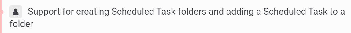

Is it possible that future updates can include Advanced Installer that can create a directory and create our tasks within this directory?
Within Windows scheduled tasks, you can create a folder and there you can create scheduled tasks.
I see that advanced installer does not have this, is it possible that I can do it in the future?
Re: Run process at system startup.
You are always welcome!
Regarding your request, please note that this has already been added in version 21.3 of Advanced Installer.
