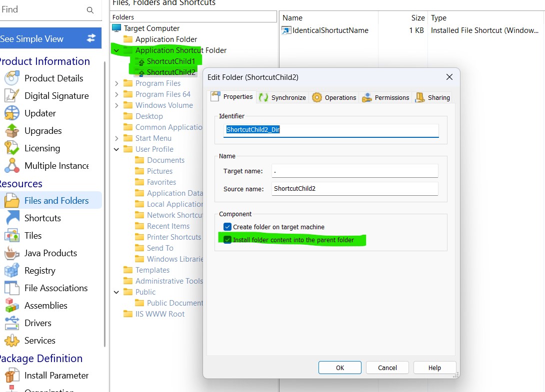

Indeed your scenario is valid and so your requirement. Unfortunately we run the related validation (same shortcut name in the same shortcut folder location) due to Windows Installer validation rules. Also, I think we never thought to this scenario.
However we do have a workaround solution.
All you have to do is to create a child folder (for each of your sibling shortcuts) under your shortcut folder in "Files and Folders" page. Then right click on each child folder, choose "Properties" context menu option and use the "Install folder content into the parent folder" option.
Then all you need to do is to add a sibling shortcut in each of the above created child folders.
Let me know if this still does not work for you.

Hi Daniel,
Thank you very much, that's a great solution! I have adapted my project accordingly.
