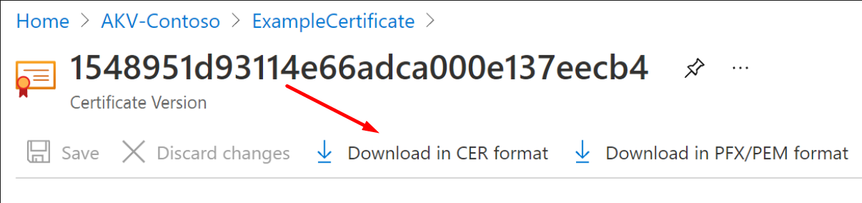

As far as I'm aware, you can Export certificates from Azure Key Vault.
Similarly, from another article:
Quickstart: Set and retrieve a certificate from Azure Key Vault using the Azure portal
I can see that there is an option to "Download in CER format":
After doing so, we can use our "Install Certificate" custom action to add the certificate to the Trusted Root.

Yes, due to some miscommunication issue, I thought the .cer file is not exportable. Actually the not exportable one is the private key. We were able to download the .cer file and install it during installation from the custom action. Now the issue is fixed.
