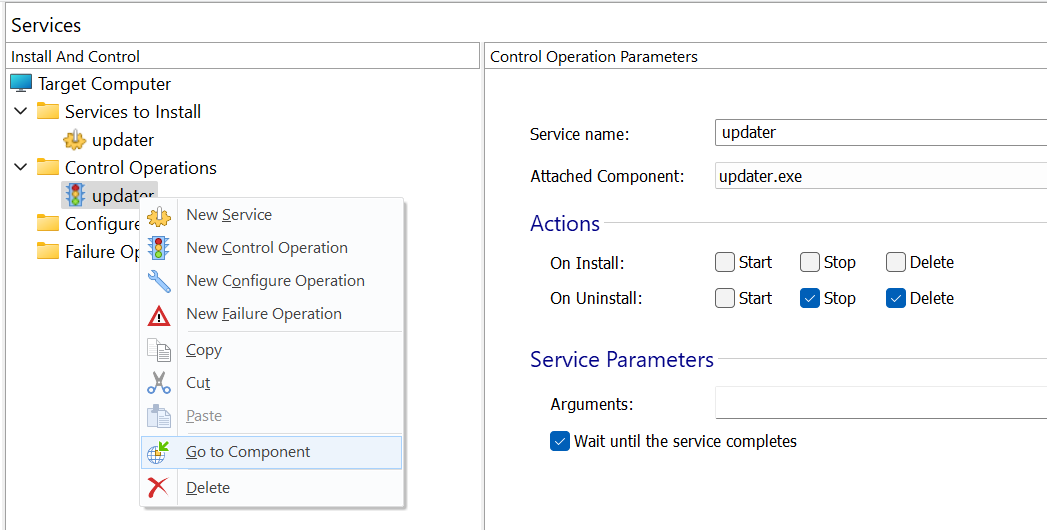

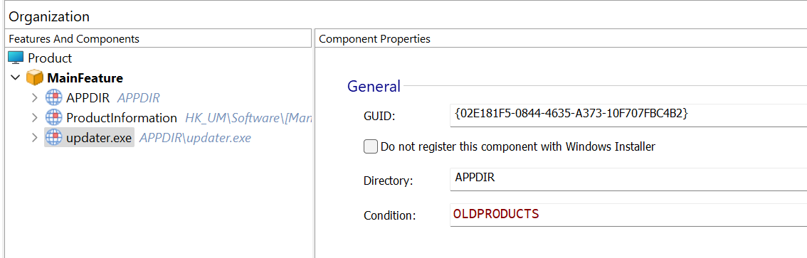

You can right click on your Control Operations --> Go to Component option and add the condition OLDPRODUCTS. In this way, the control operation will only be executed during an upgrade.
An upgrade process can be detected by using two properties:
  • OLDPRODUCTS - this property is set in the upgrading MSI if the package found an older version installed on the target machine
  • UPGRADINGPRODUCTCODE - this property is set in the MSI which is being upgraded if the package is uninstalled by a newer version
Go to Component.png (41.46 KiB) Viewed 10762 times
You can add multiple operations and condition when to execute them.
If you cannot configure the Control Operations to your needs, you should look at the custom actions approach as you mentioned.
