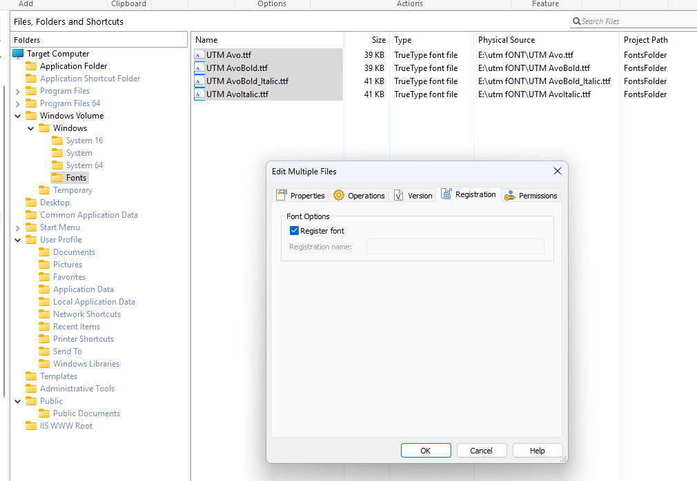

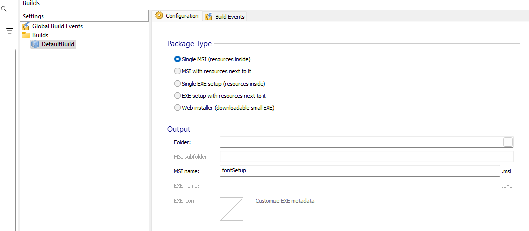

1. create a setup package that will simply deploy your application custom font; just follow the steps exposed in "How do I register a Font?" article.

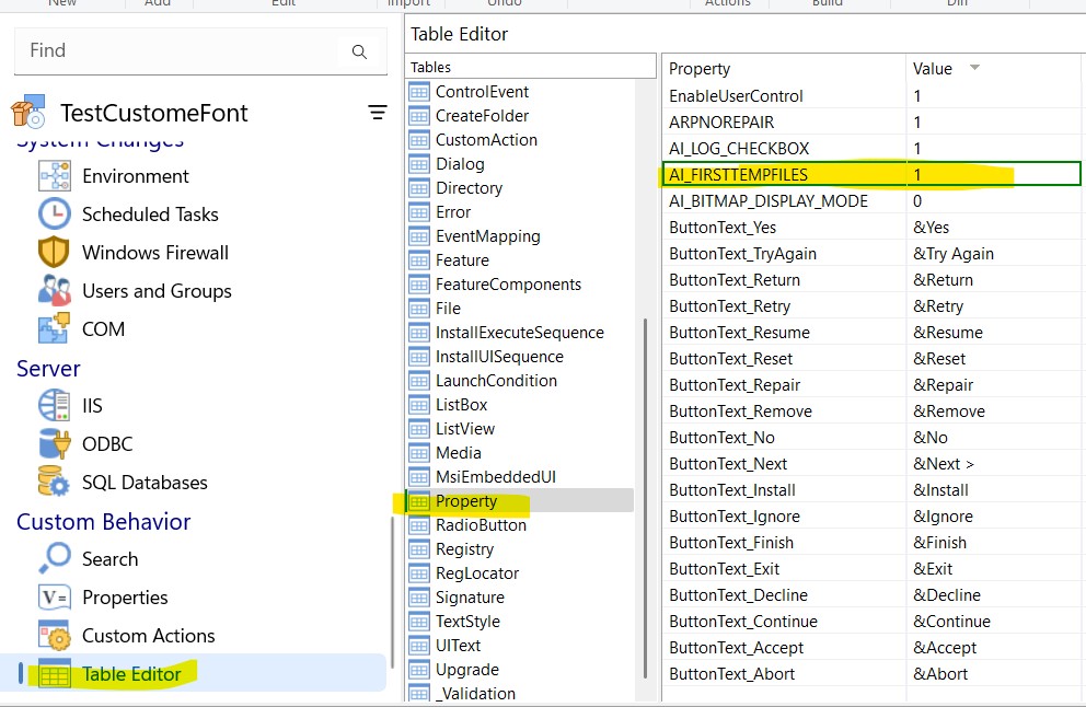

7. finally go to "Table Editor" view. In "Property" table you should simply add a new property row like this:
Property: AI_FIRSTTEMPFILES
Value: 1

I have tested your setup project and replicated the issue. It seems the behavior is caused by the fact I forgot to document one last step you need to configure. I apologize for this.
The last step you need to configure is in "Table Editor" view. In "Property" table you should simply add a new property row like this:
Value: 1
Can you please configure the above step too and let me know how this works now?
I have also updated this info on our web forum thread. Thank you for helping me to correct my post.

Re: Deploy your own application custom font before setup UI initializes
I created a new project and added properties. It works perfectly. Thank you for creating such a great guide.
