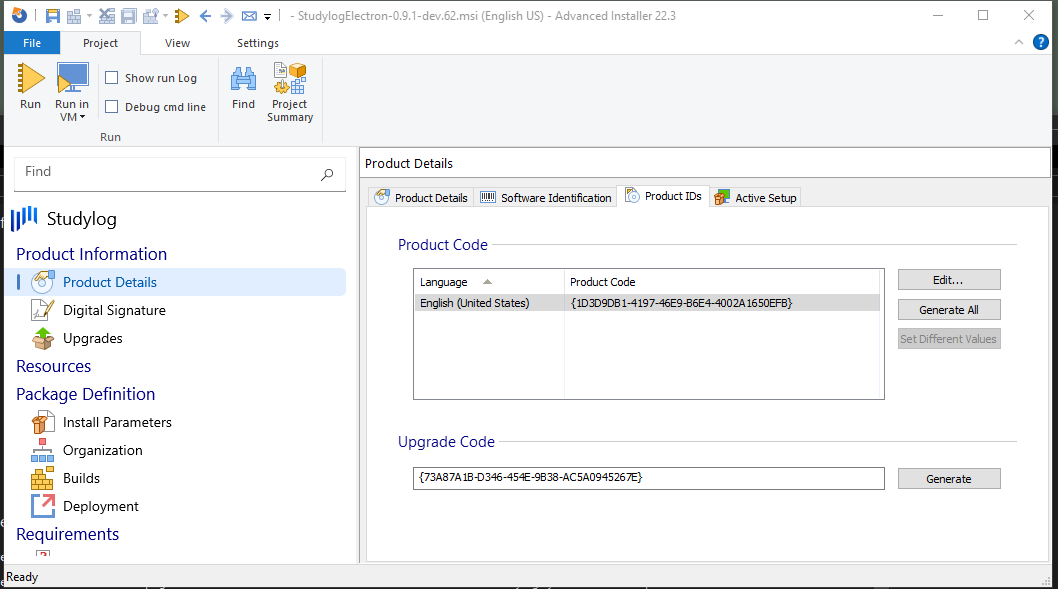

jrectorSL
Posts: 4
Joined: Thu Feb 13, 2025 6:21 pm
Re: MSI built with github action not removing older version
Please see the attached images. The versions are different, the product codes are different, and the upgrade codes are the same.
Both installers were built in github using the AI github action
