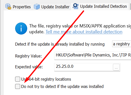

The Installed path is different, but I reference the upgrade codes in the installer. I have also tried either registry value in the updater "Update Installed Detection" and still fails.

If despite the error, you go to Control Panel, does the new version appear there?
If so, if you go under the "Update Installed Detection" tab and check the "Do not try to detect if the update was installed", do you encounter the same behavior?

We figured this out. There was a failure in the install process that wasn't logged, but after review we corrected that issue and all appears well now.
