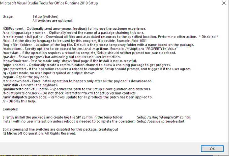

We just upgraded our .aip project from AI 19.7 to AI 22.7 (opened with AI 22.7, and re-saved, we did not do anthing else apart from that). Now we are getting an error (screenshot) when we are trying to install our TheServer.exe with ALL of the features we have. Our Office feature has a prerequisite, and it seems that prerequisite has some problems.
Could you please tell us why this happens now? I attached the config of that prereq as well.

Quick Note: at a first glance, we can see that the package is launched with wrong parameters - that's what the error suggests to us.
If you remove the "/passive /norestart" and leave only the property there, are you still encountering this issue?
You can then place "/passive /norestart" using the "Configure" button into the "Silent" field.

I think the issue here comes from the following:
The AI_PREPREQ_UILEVEL_SWITCH property basically contains the field from the "Silent UI" field, as you have set the UI Level to "Silent install (no UI)".
This was a bit confusing to our customers and therefore we removed that in version 22.8 (our latest) and rolled back to a similar approach we had before.
So, the entire command line is:
/passive /norestart /q
and that's what gives this error, I think.
The solution would be to leave the "Command Line" field with only the property and then input in the "Silent UI" field the command line, e.g.: /passive /norestart
Could you please try that and let me know if that helps?

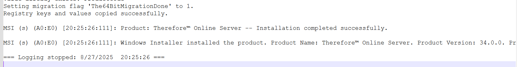

I have pre installed ASP .NET 8.0.1:
I have then installed your setup and everything seemed to be working as expected:
The above is taken from the installation log.
