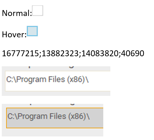

I was following the instructions as above and changed the value of the property AI_CONTROL_VISUAL_STYLE
As I wanted the Control to be white with a gray border by default and light blue with a blu border when hovered, I changed the property to this:
but when I build it the control looks as in this picture:
Why is it so?
Thanks in advance
Federica

First, you need to make sure that the Enhanced User Interface is enabled. Just go to the "Themes" page --> "Settings" tab and enable the Enhanced User Interface to "Only on install" or "Always".
Now, you need to set the AI_CONTROL_VISUAL_STYLE property using a "Set installer property" custom action like this:
  • decimalBackgroundColor;decimalOverBackgroundColor;decimalBorderColor;decimalOverBorderColor
Just follow the above steps in this thread to see how to find the color code.
I've tested this and everything worked as expected:
  • Property: AI_CONTROL_VISUAL_STYLE
    Value: 16777215;16744448;8421504;1617031
The result is: white EditBox with gray border on normal and blue color on hover.

fede071
Posts: 19
Joined: Tue May 31, 2022 11:04 pm
Re: How do I change this color?
Hi Liviu,
thank you so much. I had not realised the decimal code of a color should be found out from advanced installer itself and was using an online converter hex to decimal value.
Everything works as expected now!
