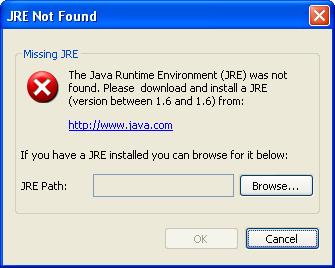

* since there is no JRE available, the native-launcher should display the "JRE Not Found" dialog:
AI - no JRE dlg.JPG (19.37 KiB) Viewed 8233 times
* leave the "JRE Not Found" dialog open

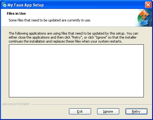

* sometime after the ProgressDlg says "Searching for installed applications", the FilesInUse dlg will trigger
* the FilesInUse listbox is empty:
AI - FilesInUse dlg - EnhancedUI.JPG (29.06 KiB) Viewed 8233 times
* click "Exit" to cancel the upgrade

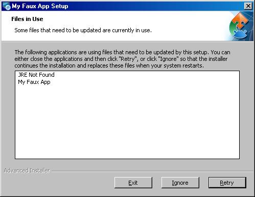

* now change your AI project to use the basic UI and rebuild version 1.0.1
* run the 1.0.1 installer with basic UI, repeating the same steps as before
* when the FilesInUse dlg is triggered, it now lists the "JRE Not Found" window:
AI - FilesInUse dlg - BasicUI.JPG (29.5 KiB) Viewed 8233 times
This behavior is always reproducible. I only used the "JRE Not Found" dlg because it's a simple example that can easily be reproduced without any knowledge of my app. (When the JRE is available and my app is actually running, I still observe an empty FilesInUse dlg.) This sharp difference between the Enhanced UI and basic UI suggests that there is a bug somewhere.

When testing against this newer version of WI, the FilesInUse dlg is not empty when using the EnhancedUI, which is good. However, there is still a difference in behavior between the UI modes (basic -vs- enhanced).
- When using the BasicUI, the FilesInUse dlg displays one entry "JRE Not Found" (same behavior as with the older version of WI)
- When using the EnhancedUI, the FilesInUse dlg displays *two* entries:
AI - FilesInUse dlg - EnhancedUI - multiple entries.JPG (27.27 KiB) Viewed 8209 times
The "JRE Not Found" entry is expected, but the second entry (which is my [ProductName] and is the name of my native java launcher EXE) is unexpected and potentially confusing to users.
Could this be fixed so that both UI modes exhibit the same behavior? In this context, I think the FilesInUse dlg should only display the "JRE Not Found" entry.
