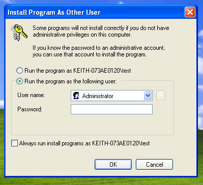

I'm trying to create a smooth installation that will work for non admin users and I don't want users to be prompted to log on (or run as) an admin user during install.
I have the following setup in my project:
Installation Folder: [AppDataFolder][ProductName]
Installation Type: Per-user only
Execution level: As invoker - default
Launch conditions > "Run only if user has admin.." is not checked
Please can you help to stop the installer prompting for admin credentials?

Hi thanks for your response, my subject line is probably slightly misleading.
The issue I am facing is that users are being prompted to enter admin credentials when running the setup, I don't want this, please see attached screenshot. It should just perform the installation.
Where would you like the .aip file sending?
Admin User Dialog
Admin User Dialog

It seems this issue is caused by the name of your built package. Just change the name of the output installer to anything other than "setup" or "install" and that dialog will go away.
