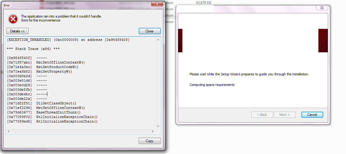

Our Quality Assurance team is facing problems during installation of our product. And It happens two time on different machines.
Please, see the attached images. Which gives the clue of it happens.

Following is the stack trace.
[EXCEPTION_UNHANDLED] (0xc0000005) at address [0x984f840f]
Stack Trace (x86) ***
[0x984f840f] -----
[0x71f87abc] MsiSetOfflineContextW()
[0x71e4a3ec] MsiGetProductCodeW()
[0x71ea5b82] MsiGetPropertyW()
[0x003d3e2d] -----
[0x003e81d6] -----
[0x003e0d26] -----
[0x003de5fb] -----
[0x003de4bc] -----
[0x003de22a] -----
[0x71df2f51] DllGetClassObject()
[0x71ef2296] MsiSetOfflineContextW()
[0x75d63677] BaseThreadInitThunk()
[0x77089f02] RtlInitializeExceptionChain()
[0x77089ed5] RtlInitializeExceptionChain()
which I could get by copying from error box.
