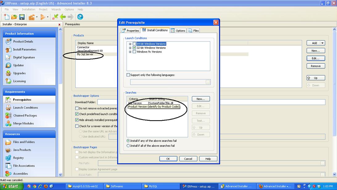

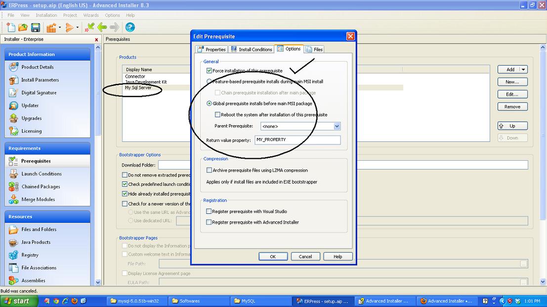

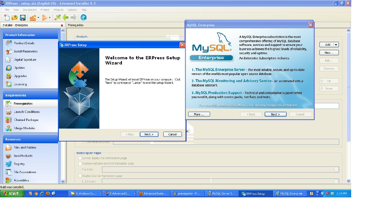

In our application we are using mysql server prerequisite to install Globally before installation of our MSI package. and i had given options as below in prerequisite option page..[img]prerequisite.JPG[/img] its is installing globally but MSI package is also installing simultaneously ..[img]installation.JPG[/img]
During Prerequisite installation its not hiding already installed prerequisite where i have given my install conditions as[img]install%20condition.JPG[/img] any one please help regarding this.

I tried to reproduce the behavior on a package with the same settings as yours, but everything worked well to me.
The already installed prerequisites are not probably hiding during installation because of the searching criteria you set in the "Install Condition" tab when edited prerequisite.
You can test those searches by pressing the "Test" button. If the result is "FAILURE" it means your prerequisite will be selected for install.
Can you reproduce the behavior on multiple clean machines? If so, can you please send us the .AIP (project file) and a verbose log of the installation to support at advancedinstaller dot com so we can investigate them? Also, can you tell us what is your target machine configuration?
