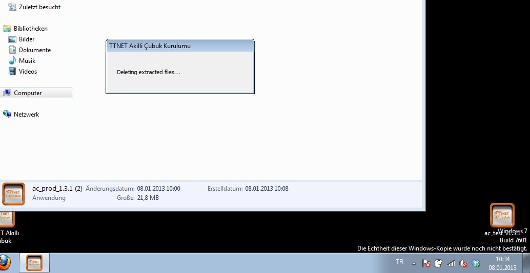

I try to install.My installer doesnt show "exit dialog page",directly open our product .OS language is Deutsch,installer language is Turkish.
Mini dialog pages comes after the progress bar.jpg and this dialog language is English.Why this dialog page(deleting.jpg) English?? I dont want to any English dialogs,can you help me ? Sorry for my English

@: redseujac : Sorry, my mistake the option "Override Windows Installer programs list entry" should be enabled, as you said. The only case I reproduce this is for a multilingual package, which I assume you have too. The solution in this case is to use the same product code for each language. You can set that product code from Product Details page, Product Ids tab. After this rebuild and test the package.
@: emrey : The dialog from "deleting.jpg" was recently included by us so the problem is that strings for all languages were not yet included for it. We rely on updating our texts with the help of our users so a delay appears.
This dialog unfortunately is not optional so you cannot choose for it to not be displayed. Our setup displays it only if it detects that deleting those files might take a longer time period and the user should be informed about that, this way avoiding situations when users try to launch the setup again immediately after it was closed.
You could change the texts by modifying the stubs we provide with Advanced Installer, see our install folder from your machine, using a resource editor.
