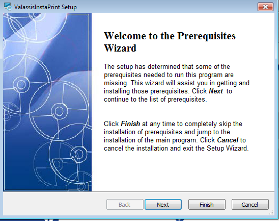

How do I customize the following two dialogs? Three things we want to do.
1) Remove the finish button in the prereq initial
2) Remove the finish button in the progress about the installer
3) Change the size of the progress bar it is not readable and the updating is so choppy it makes it look broken and the appearance that nothing is working on slow network connections. Is this due to chunked transfers?

1)Remove the finish button in the prereq initial
I'm afraid we don't have support to edit the dialogs of the pre-install prerequisites wizard dialogs.
So if you don't want the user to exit the “pre-install” prerequisite dialog without installing them, there is another approach, where your prerequisites are mandatory and the [Finish] button is disabled.
In order to achieve that you can disable the “Continue with main installation if the prerequisite is not installed” option from the prerequisites properties tab.
