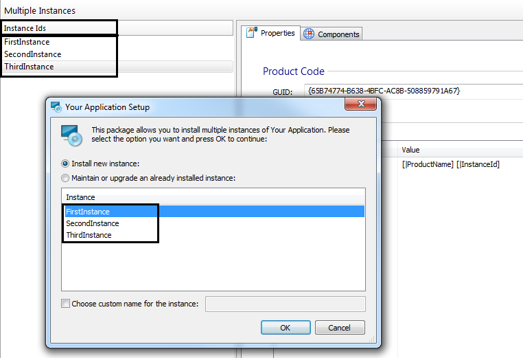

Before the 11.2 version of Advanced Installer, in order to install multiple instances you needed to define them in the Multiple instances view. So you could only install instances defined there and as many as you had defined. For example, if you defined 3 instances, you could install only these ones. So, after the first time installation of your installation package you were prompted with the following dialog, to install a new instance from the predefined list. Please see the attached image for your reference:

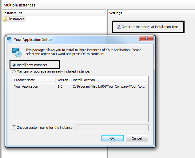

Starting with the 11.2.1 version of Advanced Installer, there is no need to define them in the Multiple Instances view. All you have to do is to enable the Generate instances at installation time option and if you run once again your installation package, after you install it for the first time, you are prompted to install a new instances. Also, you can install as many as you want, not as before as you could only install as many as you defined in the Multiple Instances view. Please use the attached image for your reference:
I am not sure about the number of instances required
If you don't know the number of the instances of the application, you can enable the Generate instances at installation time option.
