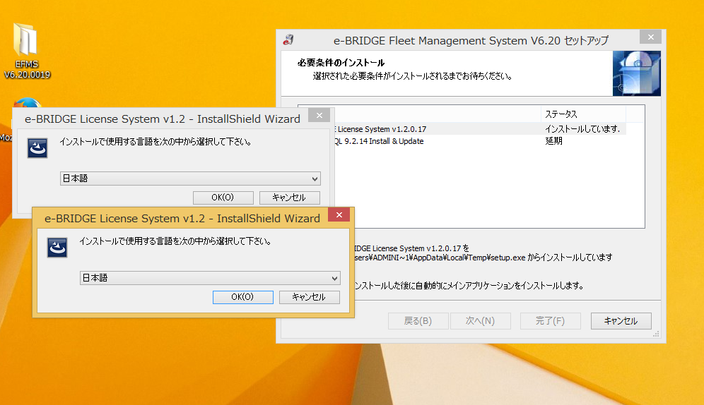

Hi Team,
Our application requires the following as the prerequisites,
1) JRE32bit
2) JRE64bit
3) License Activation Client (LAC)
4) PostgreSQL
Also, the License Activation Client (LAC) has the following prerequisites/supporting files,
1) .NET 4.5.2
2) Visual C++ 32bit redistributable
3) Visual C++ 64bit redistributable
In some Operating Systems, Once the LAC starts installing, it will try to install .NET4.5.2 and hence the system reboots. After the system reboot, The LAC setup window is appearing twice although it is specified once in the AIP file. Please find attached the screenshot as well as the AIP file for your reference. Kindly let us know the solution.
Issue Screenshot
Issue Screenshot
Llicence Related.PNG (249.09 KiB) Viewed 2985 times

Re: Prerequisite is appearing twice after autorestart of the PC in case of .NET Upgrade
This may happen if your LAC setup is auto-launching too after the computer reboot. Every time Advanced Installer installs a prerequisite (e.g. LAC) which before finishing its installation restarts the computer, then after reboot the main setup will relaunch and will also relaunch its prerequisite setup (LAC) to finish installing it. But, if your prerequisite setup (LAC) is also auto relaunching it after reboot then you will end up with two instances of the same setup after reboot.
There is no workaround you can use other than recreating your LAC setup to not trigger any computer reboot during its installation. Also, as another try you can add the ".NET 4.5.2" and "Visual C++ redistributables" as pre-install prerequisites to your main setup project, scheduling them before the LAC prerequisite.
If you have any questions just let us know.
