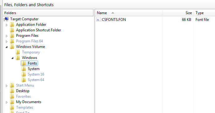

If you want your font source file to be installed directly in Windows Fonts folder, then please go to "Files and Folders" page and drag your font file under "Windows Volume\Windows\Fonts" folder. Let us know if this helped.
That is the location that we have been using all along:
