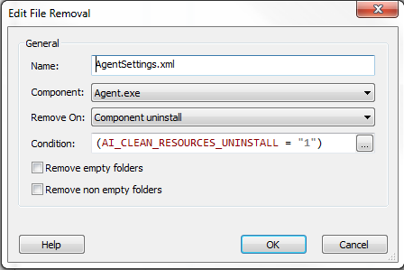

Here are the settings I am currently trying (and uninstall does NOT remove files )
Folder:
File:
Posts: 4971
Re: Uninstall does not delete file created by application
Hi Mike,
On the first hand, you only need the "File Removal" operation if you want to remove that file, the "Remove folder" option is not needed anymore.
On the other hand, I see that you have the "AI_CLEAN_RESOURCES_UNINSTALL = 1" condition set for these operations which means that this property should be set to "1" during the uninstallation, but I didn't find it on any of your dialogs. Anyway, you can remove that condition without any problem and the file should be removed as expected.

Posts: 366
Joined: Wed Dec 30, 2015 5:40 pm
Thank you ... removing the condition, fixed the issue.
