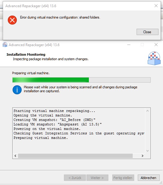

at the moment i want to try the feature "Repackage over Hyper-V" so i started the Repackager an choose my settings. All works great, Snapshot will created, vm boots up but after boot up, AI runs into error.
Could you inverstigate this ?
See Screenshot for config an Error message.

Re: Repackage run´s into Error on VM
Can you please make sure that the setup package your are trying to repackage is not placed on host machine in the root folder of a partition (e.g. C:\, D:\, etc) and try again? Our Repackager shares resources between the host and virtual machine using a shared folder on the host machine. The shared folder is the parent folder on disk of the setup launched to be repackaged.
[EDIT]: Also, for testing purposes only, if on your host machine is not installed an English operating system, can you please create a username with the following name (must be in English):
Everyone
and then test again to launch the Repackager?
Let us know how this worked.
Worked great, installed the OS Provision tools on my virtual Machine and create "Everyone" on my Host.
Thx
Matthias
Hello Matthias,
Thank you for your feedback. I can confirm you that the original issue was caused by a small glitch in our Repackager which is replicating on non-English operating systems. A fix for this issue was already added in Advanced Installer and will be available in a future version. Thank you for bringing this to our attention.
We will update this thread as soon as the fix will be out.
This was fixed in version 13.8 of Advanced Installer released on March 30th, 2017.
