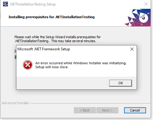

Hi Dear Team,
Please Help to sort out the problem I am working on this from last week but not found any solution except system re start.
Issue is this when we Install the Microsoft .NET Framework 1.1 as a pre requisite with installer setup first time its run successfully.
Then I will uninstall the Microsoft Framework and installer exe and start again installation.
This time on pre requisite show this error
"an error occurred while windows installer was initializing. setup will now close"
Please help I'm waiting for your response.

I think that you are not able to completely uninstall .Net framework without a reboot. Have you tried to look at the logs of the .Net installer?

If I install Microsoft .NET Framework 1.1 Separately
Then it work fine install / uninstall and again installation done successfully.
In case of Advance installer First time install successfully when I will uninstall and start again installation then showing this error.
We are using Advanced installer with profession License.
Can you help me to sort out this error.

The only reason I can think about is that the application is still running at the moment the framework is being uninstalled

First of all, please note that the encountered error is thrown to the .NET Installer itself, not by your setup.
After doing a little bit of research, it looks like Ricardo may be right.
After installing & uninstalling, could you pelase do a system restart, then try to install the setup once again and let me know if this issue still persists?
