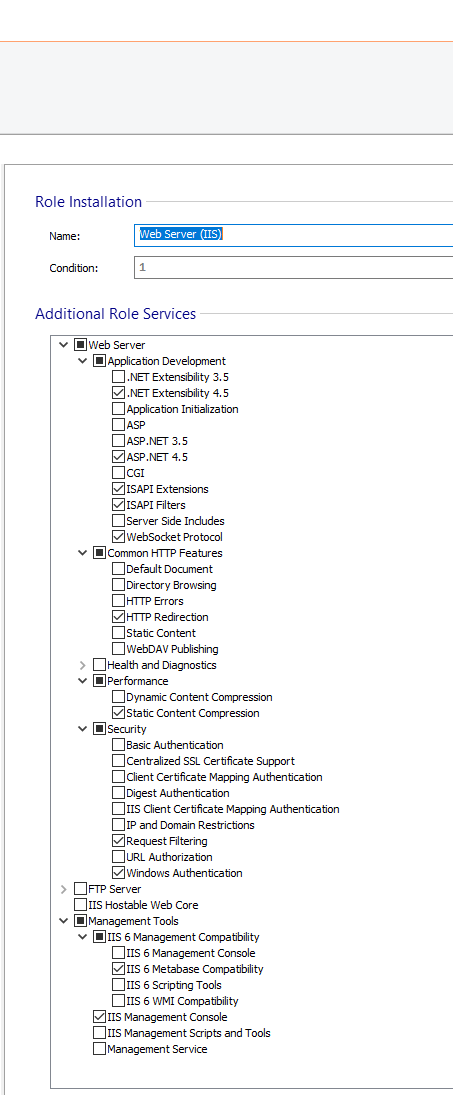

Please post a screenshot of Requirements -> Prerequisites -> Windows Server Roles -> Web Server (IIS)
Ours is
and as far as I see it, AI sticks to that...

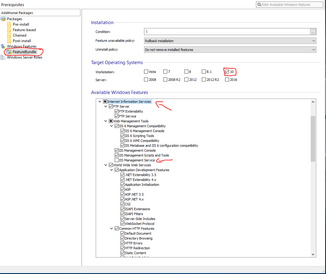

Hello Andre and welcome to Advanced Installer forums,
In order to achieve that, you can simply select all the IIS features that you want to be installed. This can all be done from "Prerequisites" page --> right click on "Windows Features" --> "Add a new Feature Bundle" --> select the "Target Operating Systems".
Please have a look on the following screenshot:

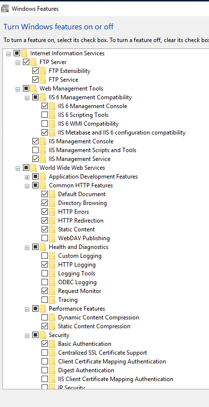

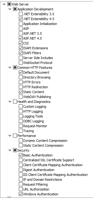

First screenshot are the features I select in AI:
Second screenshot is what is enabled in Windows after running my install:
You can see there are a lot more features installed than I had selected. None of these additional features appear to be dependencies of the features I selected, so they shouldn't be installed.
