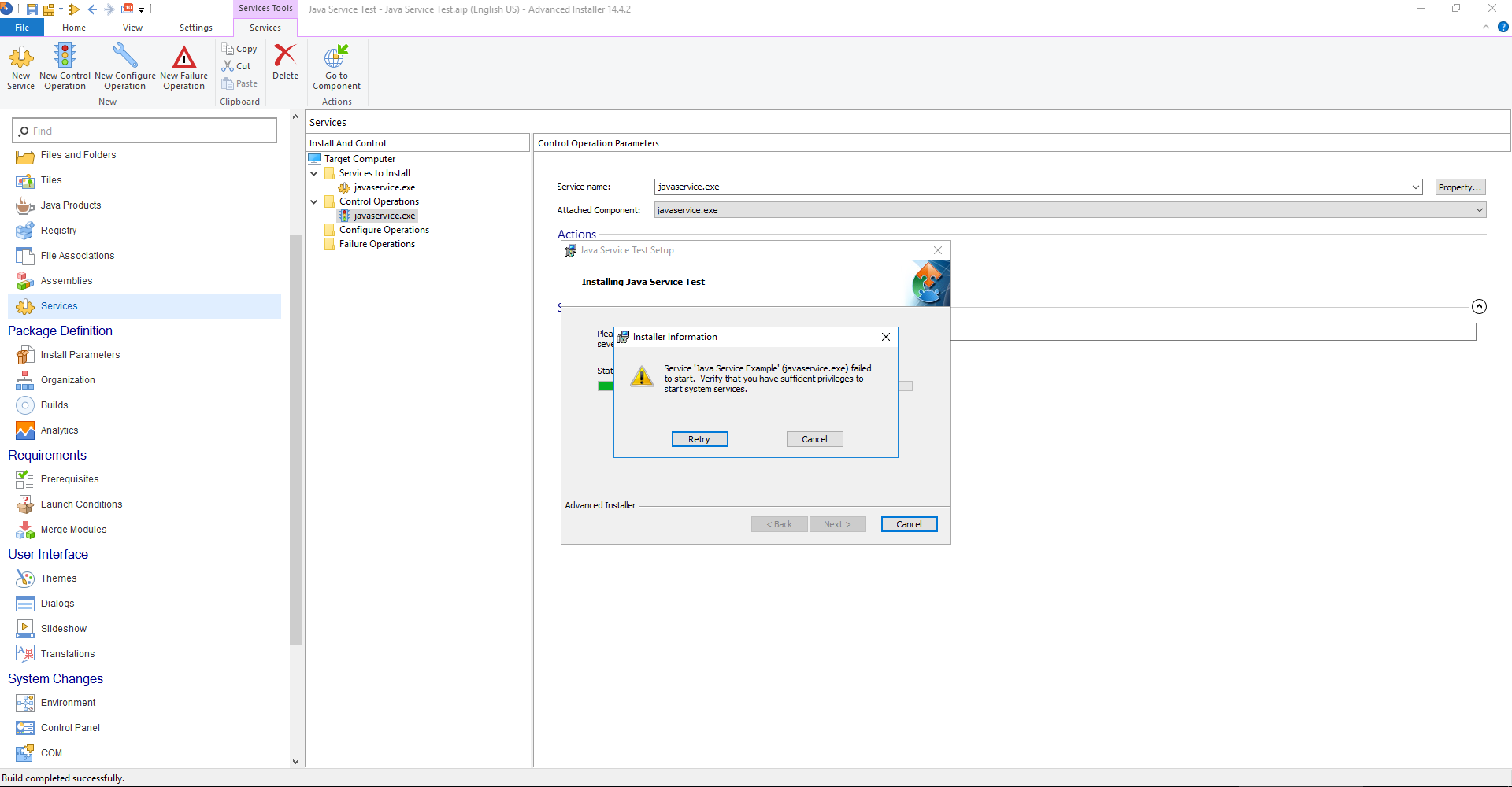

I'm having the same issue with my project. However, none of the above steps helped me fix it.
When running the installation file, the installer takes forever at the step "Starting Services" before eventually failing with the error message "Service 'XXX' (XXX.exe) failed to start. Verify that you have sufficient privileges to start system services." and rolling back the installation.
This also happens for the Creating a Java Service Installation Tutorial.
As for my environment, I'm running Windows Server 2016, and am logged on with the Administrator Account.
Can somebody please help me with this?
Advanced Installer Service Start Fail.png (91.67 KiB) Viewed 23184 times
Re: Windows Service Fails to start
The Java Service Example installation setup may fail during service installation if there is no 32-bit version of JRE installed on target machine. Please note that our EXE Java Launcher will search for an installed JRE to alunch the java app. So, when the service start operationis triggered our EXE Java Launcher will search for and installed JRE to launch the java app. If none found then the start operation will fail.
