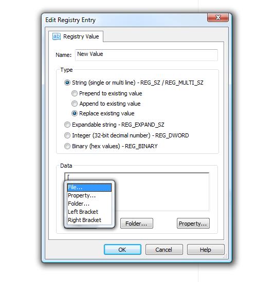

The simple version, but with square brackets. Use the support included in Advanced Installer to generate the reference, as in the attached picture.
Bogdan

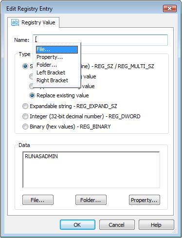

Actually, you can reference your file in the "Name:" formatted field and the "Data:" text field should type only RUNASADMIN, just like in the following screenshot :
Let me know how it works for you.
