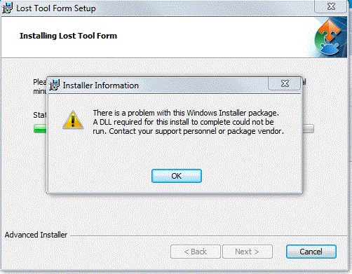

The attached MSI and its aip will install on a 32 bit XP but gets a missing DLL message on Windows 7 Ultimate 64bit. Image of error is also attached. I am using 8.0.2 on Windows 7 Ultimate 64bit.

Error message
Error message
IIS Install Error.GIF (62.97 KiB) Viewed 4613 times

I have tested your project and I cannot reproduce the behavior on a Windows 7 64-bit machine.
This type of error usually occurs when a custom action fails. Please send us the verbose log of the installation to support at advancedinstaller dot com so we can investigate it.

Here is the log file.
I did not define any custom actions of my own however the error seems to be related to OnIIsInstall CustomAction AI_IIsInstall. I removed the source files but could send them if needed. The aip is still attached.

We started investigating the issue but we need some more information to properly localize the problem.
Have you tested this package on other machines perhaps ones that have different OSs? If not, please do so and give us the results.
Since we cannot reproduce the issue on any machine after building the AIP, we will also need you to send the MSI that is causing the problem.
Can you please upload the MSI to an online location and post the link here or in an email to support at advancedinstaller dot com?

I tried it on a different W7 64bit system and it worked. Any ideas? The msi link is in an email.
