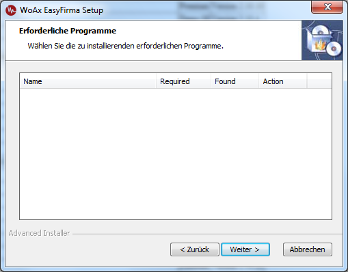

How can the empty prequiste window be removed when all the prequiste are already installed?
see attachement.

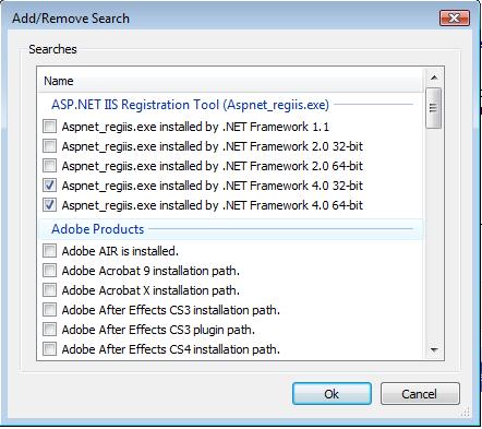

Is there not a less complicated way to do this?
As far as I see in the search if see no
"prequiste installed" condition or
"registry key exits" to get the value and also I must make or because of 32 and 64 bit because

Unfortunately there's no easier then with searches way unless you're considering custom actions.
You could try to add a couple of predefined searches and use them with "Show only if". The somewhat related predefined searches are:
However the condition will be as described (the dialog will be shown whether "Aspnet_regiis.exe" is installed)
ASPNET_REGIIS_40_PATH_X64 OR ASPNET_REGIIS_40_PATH_X86

Re: avoid empty prequesite window
After later investigation it seems this issue was target OS related, not if the prerequisite is installed or not. This means that if you have a prerequisite with 64-bit supported windows version option disabled, it won't be shown in the dialog when installing on such a machine. This can lead to the list in the dialog to be empty.
The only solution in this case is to use "Show only if..." using VersionNT64 property as described in the following article:
How do I install resources based on the Operating System version?
We'll improve the behavior in this area by creating a property which will ease the dialog's conditioning, but the "Show only if" step will still be required.
