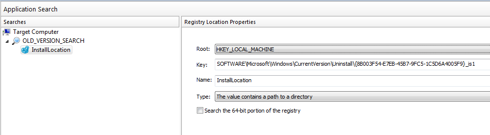

Thank you, that got me to the next step but I am still not there 100%. I changed things up a bit in my search. Please see attached screenshot1.png. The search now returns the installation directory of the program I want to uninstall. Inside the directory, there is a file called "unins000.exe". When I run the test of the search it returns: 1: C:\Program Files (x86)\ProgramName\
In the Custom Actions section, I added a "Launch file from property" like you said, but I am unclear on what needs to be filled in for the parameters. Please see attached screenshot2.png. The current configuration does not run the .exe as I expect so I must be doing something wrong. Thanks again

Hi Colin,
You can try to modify the next settings in your project:
- in your custom action properties clean the "unins000.exe" parameter from the "Command" text field
- in the search properties change the type of the search ("Retrieve the raw value" instead of "The value contains a path to a directory") and select the registry value that points to "unins000.exe"

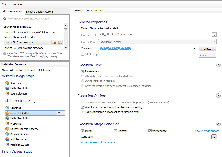

Okay I moved "Launch file from property" below "Preparing" and then checked the options you stated. Then I added a "Launch file or open URL" custom action and placed it below "Searches". Here is what they both look like now but still no success. I've also attached the log file

Posts: 4971
Re: How to use custom search results
Please verify that the uninstall process called by your custom action does not conflict with the current installation process (this usually happens when two MSI packages try to run at the same time).
Also, you can use only one of the "Launch file or open URL" and "Launch file from property" custom action, it is not necessarily to use them both. In your case they do actually the same thing.
crmiller87
Posts: 9
Joined: Wed Jan 09, 2013 12:30 am
Hi Eusebiu,
I took out the "Launch file from property" and left "Launch File or URL" in there. However I found out that putting double quotes around [OLD_VERSION_SEARCH] was not working so I tried taking them out and it works now. Thank you for sticking with me and helping me get this to work
