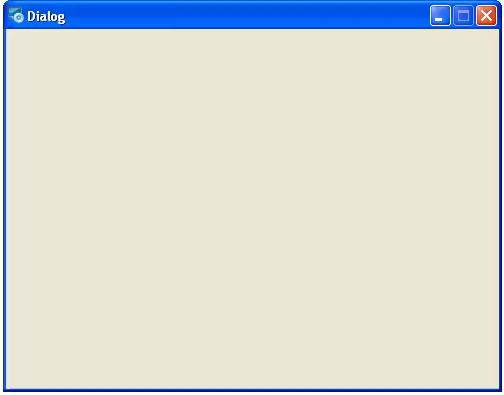

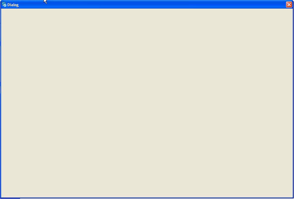

While testing we found flickering issue while launching the setup. We tried to analyze this by using some video recorder tool, and found that before the "Welcome screen" we get to see two more screens. I have attached the same
First screen
First screen
Second screen
Second screen
Third screen
Third screen
Can you please help me in fixing this(flickering problem)

I'm afraid this is the normal behavior. This happens during "PrepareDlg" loading of the user interface controls. However, if you want to remove the first screen state (from your attached first screen) then you can send us an e-mail to support at advancedinstaller dot com regarding this and we will give you a fixed exe for Classic theme (which will skip the first screen state).
