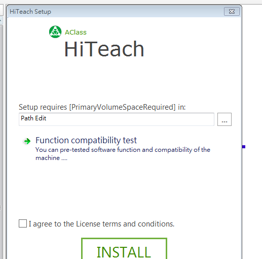

I'm experiencing the same problem with the Black Surface theme. I've tried tips in this post and updated my professional version to 10.2 and I still get the same problem. To be honest I only updated the maintenance to solve this problem and it didn't resolve the problem. What am I missing?
Theme Surface.JPG (28.75 KiB) Viewed 21771 times
Re: Surface Theme Border
I'm not sure why this happens. Can you please send us the .aip (project file) to support at advancedinstaller dot com so we can investigate it? Also, can you try to isolate the behavior in a sample or give us a detailed step by step test case scenario so we can reproduce and investigate this?
