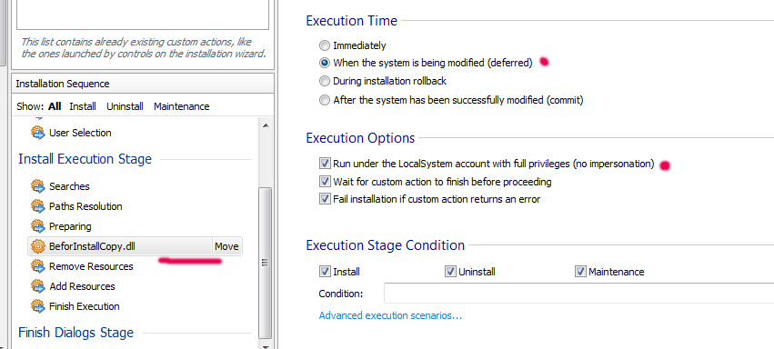

Can you please follow the steps below and see if the behavior persists:
- go in the Custom Actions page
- using the "drag and drop" method move your custom action under the "Install Execution Stage -> Preparing" action group
- in the right pane check the "When the system is being modified (deferred)" radio button and also check the "Run under LocalSystem accound with full privileges (no impersonation)" checkbox
- build and run the project

as you can see, I've done it as you wrote.
The whole changed I got, my browser is gonna start always(it hasen't happend before)
The Errormessage is still the same

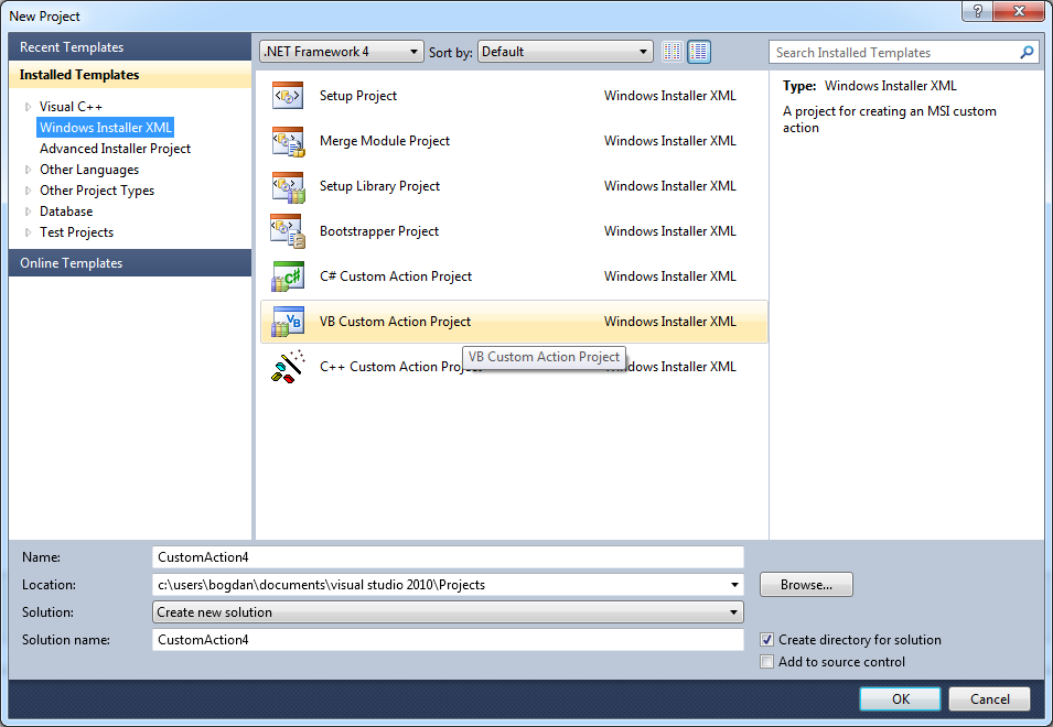

It seems that the DLL you created is not fully fledged. In order to create one, first install the WiX Toolset free software and then create a "VB Custom Action" project like in the image below.
VB Custom Action.png (74.29 KiB) Viewed 17085 times
