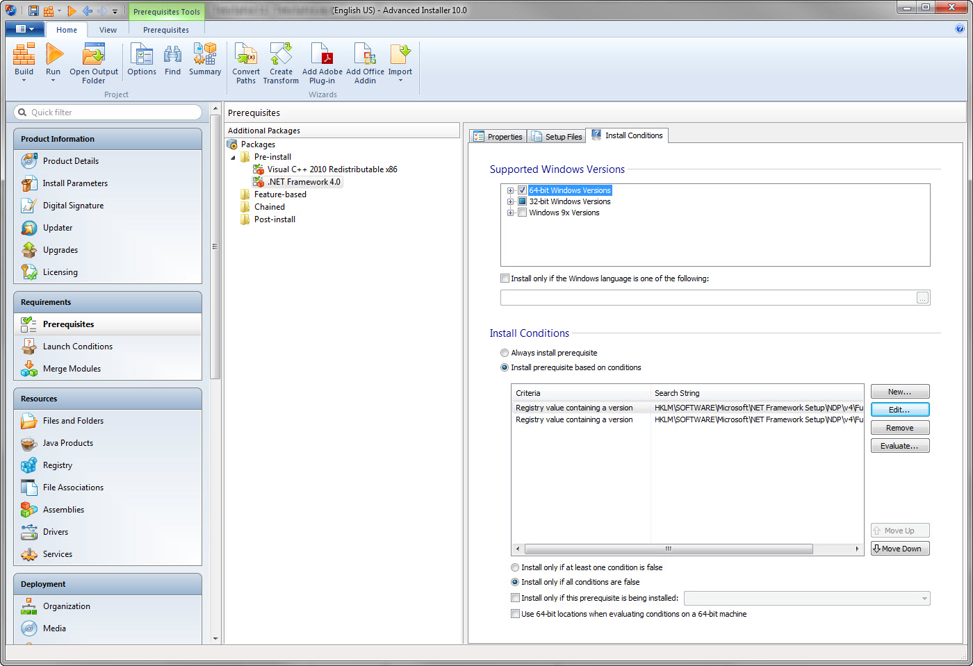

Suddenly "Framework 4.0" and "Visual C++ 2010 Redistibuable x86" will no longer installed.
Any Idea what's going wrong.
I can't remember to changed anything.
I checked the Project file in to the Team Foundation Server as it runs.
See attached Screenhots
Best regards
Horst

The Problem I had was, that the Setup of my application dosn't check the prerequirements on install procedure.
Example:
- I have a pure Windows XP (without Framework 4.0)
- Running my Setup on that machine dosn't detect that there is no Framework 4.0 on the machine.
- It installes my Application without to install Framework 4.0 before.
If I build my Setup with "Build All", it works as before :-)
I dosn't have changed anything in the Installer Project, but select "Build All" ??!!
If I will found more details about this behaviour I will let you now.
Best regards
Horst

The problem you encounter could be the same as discussed in the .Net framework not installed on Windows XP SP2 thread.
