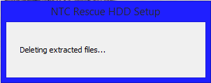

2) I want to hide this dialogue
Of course, if we not check "Do not delete extracted MSI and CAB files" at Builds Page, the "Delete extracted files ..." dialogue will display. I just want to make it will run silent.

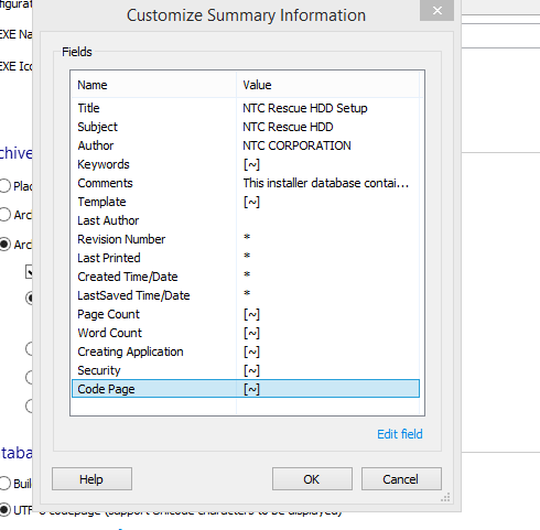

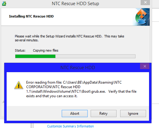

3) I disable some field like this ( customize summary Information at Builds Page)
I'm not sure but seem it is reason why I get this error when try to install my app.
Can you tell me why? Thanks
I'm afraid that the "Delete extracted files" dialog cannot be hidden.
When the package is built, the CAB files are created based on the information found in the "Summary Information" section, but changing the "Word Count" field to an empty value would mean that all the files will be placed outside the package and that is why that error is thrown.
So, if you want to change that field you can use the "Place files unpacked next to the MSI database" option from the same page, but I'm not sure if this is suitable for you.

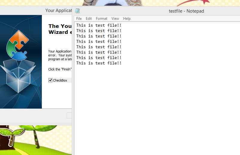

I add a published event for finish button at "Fatal Error" Dialogue: Launch .txt file custom action. But the dialogue can be closed only if .txt was closed. This error is not metter with "show log file" check box. (log file was opened and dialogue exit without need to close log file) Can u tell me why? Thanks
Posts: 4971
Re: Dialogue Page - Some question
In order to have the same behavior as the "show log" checkbox, you should go in the Custom Actions page and uncheck the "Wait for custom action to finish before proceeding" and "Wait for return code at the end of the sequence" options for the custom action that you use as a published event.
