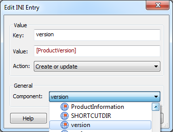

I looked over your AIP file, but I noticed that you set the "Permanent" flag for the component related to the "version" folder, not for the one related to the "version.ini" file. In this case, you can try to move the resources of the INI file in the component related to the "version" folder.
To achieve that you can either select the "version.ini" file, press the "F8" keyboard button and move its resources in the "version" component from the Organization page or you can edit each entry of the "version.ini" file and select the "version" component from the "Component" combobox as displayed in the image below.
Edit INI File.png (16.96 KiB) Viewed 6216 times
