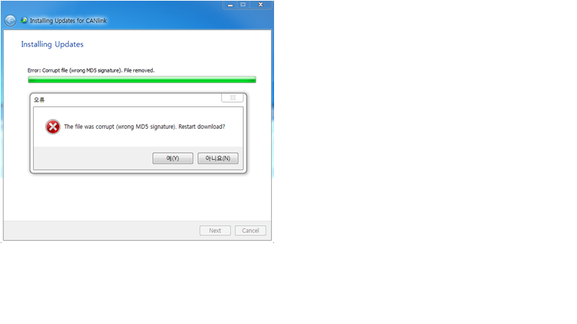

Hi
When I add a certification in version1 and I don't add a certification, updater stops
And I can check the message..
But!!
I make two different certificates and test updates.
I thought that it can't update because each file has different certificates.
But It can update.......
What is the problem?? TT
Re: digital signature
I'm not sure why you are encountering this behavior. Can you please make sure that the "Compute MD5 signature from file" option is enabled in your updates configuration project and see if the behavior still persist?
tjwlsdkzzz
Posts: 26
Joined: Fri Sep 12, 2014 10:54 am
I made two files, version1 and version2(version2 is )
2. version1 certification and version2 certification is different.
3. I think the update from version1 to version2 should failed because each certification is different. But, the update works smoothly.(the update didn't fail)
So, my question is
1st) the reason why the update didn't fail.(Why does it work well?)
2nd) To proceed like number3 above (to check fail of update), what should I do?
The update process when you are using different certificates may fail only if you are implementing the installation of the updates without elevation mechanism, otherwise it should work without any problems.
If this is not your case, please make sure that your are picking the right file when you are creating the updates file.
