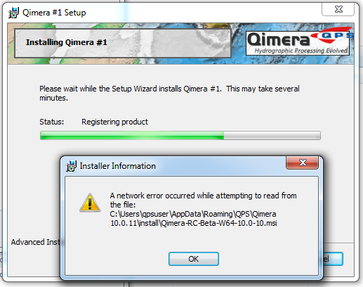

I realize that work has probably not progressed as we have not seen any updates. The following information is intended to help clarify what I see as two multiple install issues (however one of the issues actually relates to the same functionality that would exist for single instance upgrades). Here is the data (w/ Advanced Installer 12.0):

    • Issue 2: Upgrade of second+ instance fails with the message captured in the attachment;

Is the second issue the same as what we are discussing here? Is the first issue a known issue?
In the attachment below you can see that it looks like Advanced Installer is trying to access an archive of the MSI used to run the install for that instance (I think that MSI's are archived for this purpose (and repair)) but I think that it is looking in the wrong location?
When I look in the C:\Users\qpsuser\AppData\Roaming\QPS\Qimera 10.0.11 area I only see the MSI for 10.0-11 (the MSI for the version that I am upgrading to) but the above error message is attempting to use/run the MSI for the previous install. When I look in the C:\Users\qpsuser\AppData\Roaming\QPS\Qimera 10.0.10 area, I do not see any MSI's being archived for future repair/removal operations.

Regarding the issues you related, I'm afraid that the information you gave us is not enough to replicate and investigate them. So, can you please try to give us a more detailed test case which we can follow to replicate the issues you encountered? It would be really useful for us if you could isolate the behavior in a buildable sample (AIP + its referenced files) and send us to support at advancedinstaller dot com so we can test and investigate on our side.
