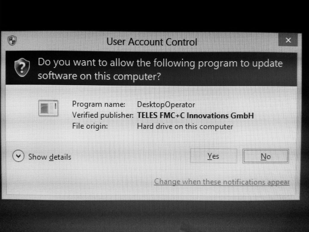

When I tried with /qr, I get the following window
So ,is this happening because of the "User Account Control"?

Yes, when the application is uninstalled in silent mode, the UAC is not displayed, but the uninstallation fails because the application does not have the necessary permissions.
In order to give administrator rights to the application, you should launch the uninstallation from an elevated console (a console that is launch using the "Run as administrator" option).

Thanks. This worked.
