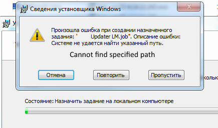

Error 4106. An error was encountered while creating a scheduled task: "Updater LM.job". Error description: <the system cannot find specified path>.
MSI (s) (34!CC) [16:20:37:570]: Transforming table Error.
If I skip the error window, the installation finished succesfully. The task is created in Task Scheduler, but there is no job file in c:\windows\tasks folder.

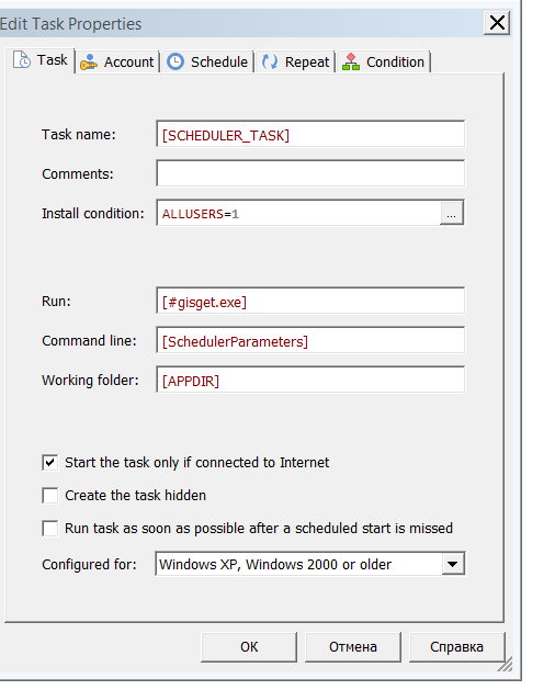

Here is the task settings dialog:
