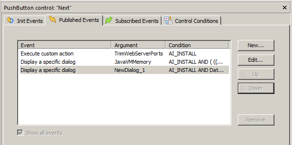

[solved] Can not remove "Display a specific dialog" Event
I followed your instruction for handling empty edit boxes http://www.advancedinstaller.com/user-g ... field.html.
Now i am not able to remove the published event any more.
Any ideas?

Hi Dan,
your solution worked.
For everyone else having this problem: There was a "DatabaseFile_Cond" condition associated with the "Display a specific dialog" event (No idea how I putted it there). By expanding the tree of my dialog I could delete this condition and with this I could delete the event. The reason why the tutorial did not work was that I used the event "Display a specific dialog" instead of "Display a specific child dialog".
The condition is created when you click on the "Show only if ..." selection. To delete the condition, expand the dialog, select the condition and then chose the delete option.
