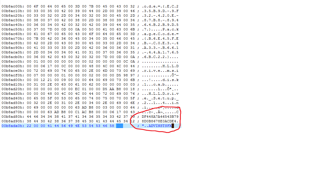

hi, I want to add some string data (like download server IP) at the end of installer. But looks the the sign is signed, and change any byte will cause install fail.
Is it possible I can avoid sign the installer?

It is not working. No matter check/uncheck the "sign" check box, it always generate checksum at the end.
If you have any hex editor like ultraedit, you can reproduce this issue.

The issue happen if I select "single exe setup" in "builds"->"package type" config page.
If this case, advanced installer always generate checksum at the end and verify the checksum during install.
