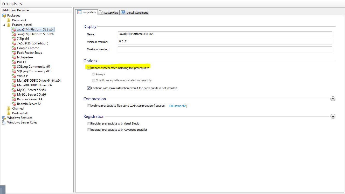

We have the same problem, the setup restarts after every reboot.
We have several prerequisites but none of them have "Reboot system after installing the prerequisite" (see image).
All prerequisites witout "Reboot system after installing the prerequisite"
Sometimes, the Advanced installer Setup creates a two-step installation for no apparent reason, rebooting automatically. A resume window is displayed asking to continue, although all the components have already been correctly installed .
