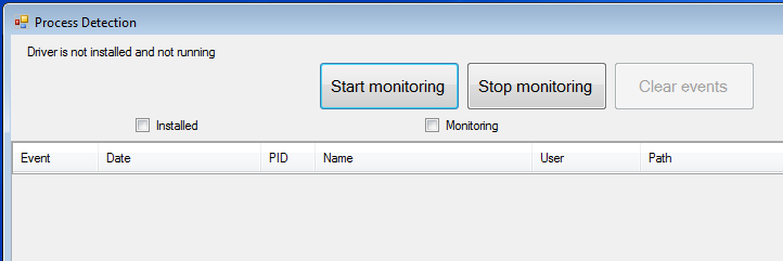

Here is a snapshot of our test program after running the install
NOTE: the "Driver is not installed and not running" is the important part of the this screen shot:

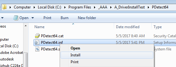

Step 1:
Navigate to the driver folder. Right click on .INF file. Click install. Driver successfully installs (no error messages are given)

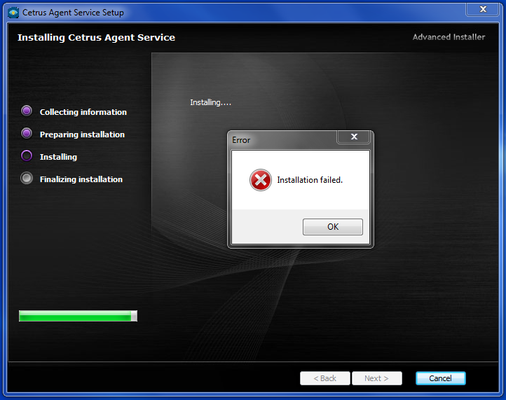

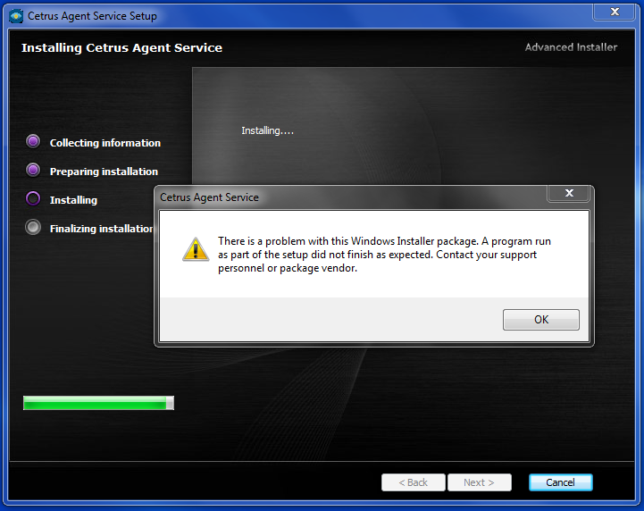

My install fails:
