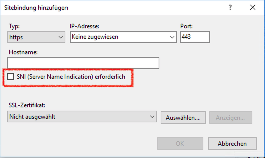

when I'm creating a new https-"Website Binding" for a IIS Sites configuration, I could activate the "Server Name Indication" in IIS.
This option exists in IIS since Win8.
Could you tell me how I can achieve that in Advanced Installer?

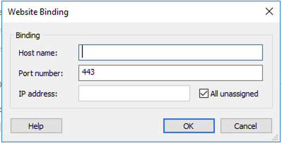

Re: How to set Server Name Indication in Bindig Configuration
Hello Catalin,
thanks for adding the feature.
I've tried to set the value, but the checkbox is not enabled:
Am I missing something?
The web-help has not been updated
Éric.

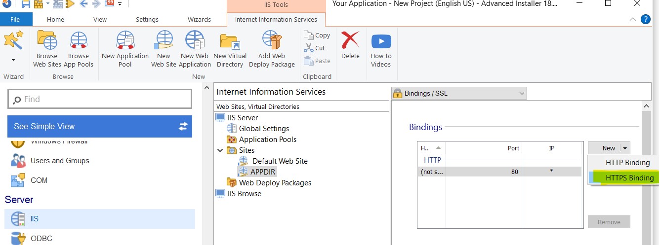

Hello Éric,
In order to use this option, you need to make sure that you choose HTTPS Binding, only for an HTTPS Binding the "Require Server Name Indication" option can be set.
So, please make sure you select an HTTPS binding to configure. See attached screenshot.
Hope this helped,
