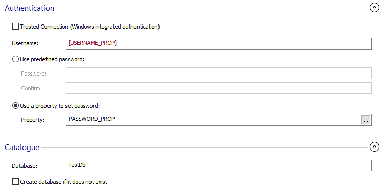

CREATE DATABASE TestDb ON
  ( FILENAME = N'$Install_Path$TestDb.mdf' ),
  ( FILENAME = N'$Install_Path$TestDb_log.ldf' )
FOR ATTACH ;
and of course i put database name in Predefined section in database server of AI
and one more thing is that i disable DatabaseCombo in SQLServerConnectionDlg because i think i do not need to set it.
is all i noted is wrong and the Database_Prop must be set?
please give a solution. i attach image from my predefined connection
thanks
Predefined connection

Re: attach sql db file show me error
First of all, please accept my apologies for the delayed reply, but we were quite busy lately.
Thank you for the provided files.
I was indeed able to replicate the behavior.
Here is what needs to be done:
1. go to "SQL Databases" page --> "DlgPredefinedConnection" --> in the "Database" field, change the database name from "TestDb" to another name (this is required because your script already creates a database with that name)
2. check the "Create database if it does not exist" option
3. now please go to "Files and Folders" page --> double click on the "TestDb.mdf" file --> "Permissions" tab --> "New..." --> set "Full Control" permissions for the [GRP_USERS]
4. repeat step 3 for the "TestDb_log.ldf" file as well
5. rebuild the project & retest the scenario
